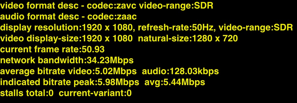

Eurosport Player - alle tallene.
Eurosport Player bitrater

Viaplay Sport live stream.
Viaplay serier.
Viaplay serier.
Viaplay serier.
