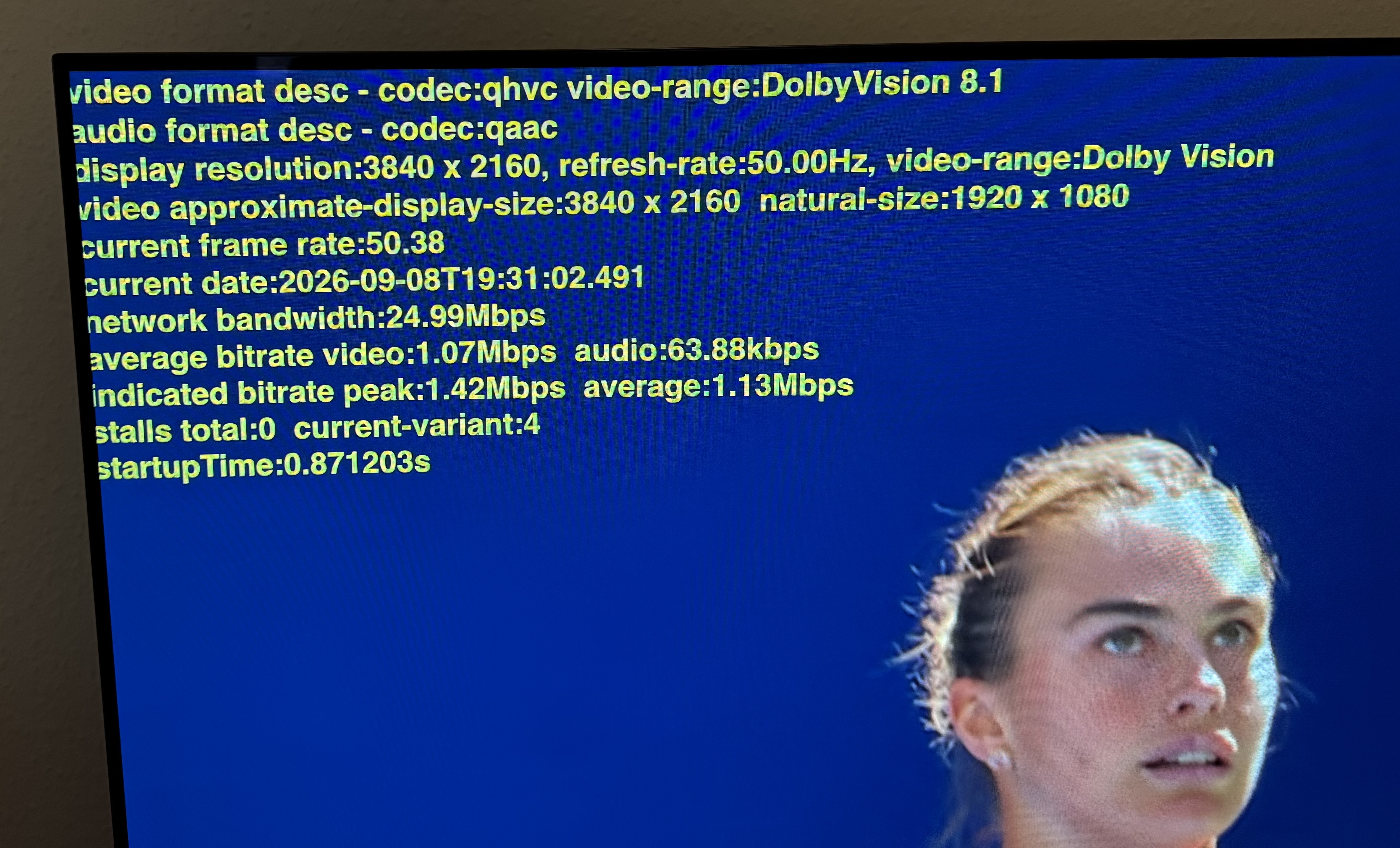

US open er i DolbyVision på HBO Max sport
video format desc - codec:qhvc video-range:DolbyVision 8.1
audio format desc - codec:qaac
display resolution:3840 x 2160, refresh-rate:50.00Hz, video-range:Dolby Vision
video approximate-display-size:3840 x 2160 natural-size:1920 × 1080
current frame rate:49.91
current date:2026-09-08T19:29:54.490
network bandwidth:77.99Mbps
average bitrate video:9.62Mbps audio:64.12kbps
indicated bitrate peak:11.78Mbps average:9.81Mbps
stalls total:0 current-variant:10
startupTime:0.871203s
Senest rettet af Brixen 09 sep 2026, 13:13, rettet i alt 4 gange.

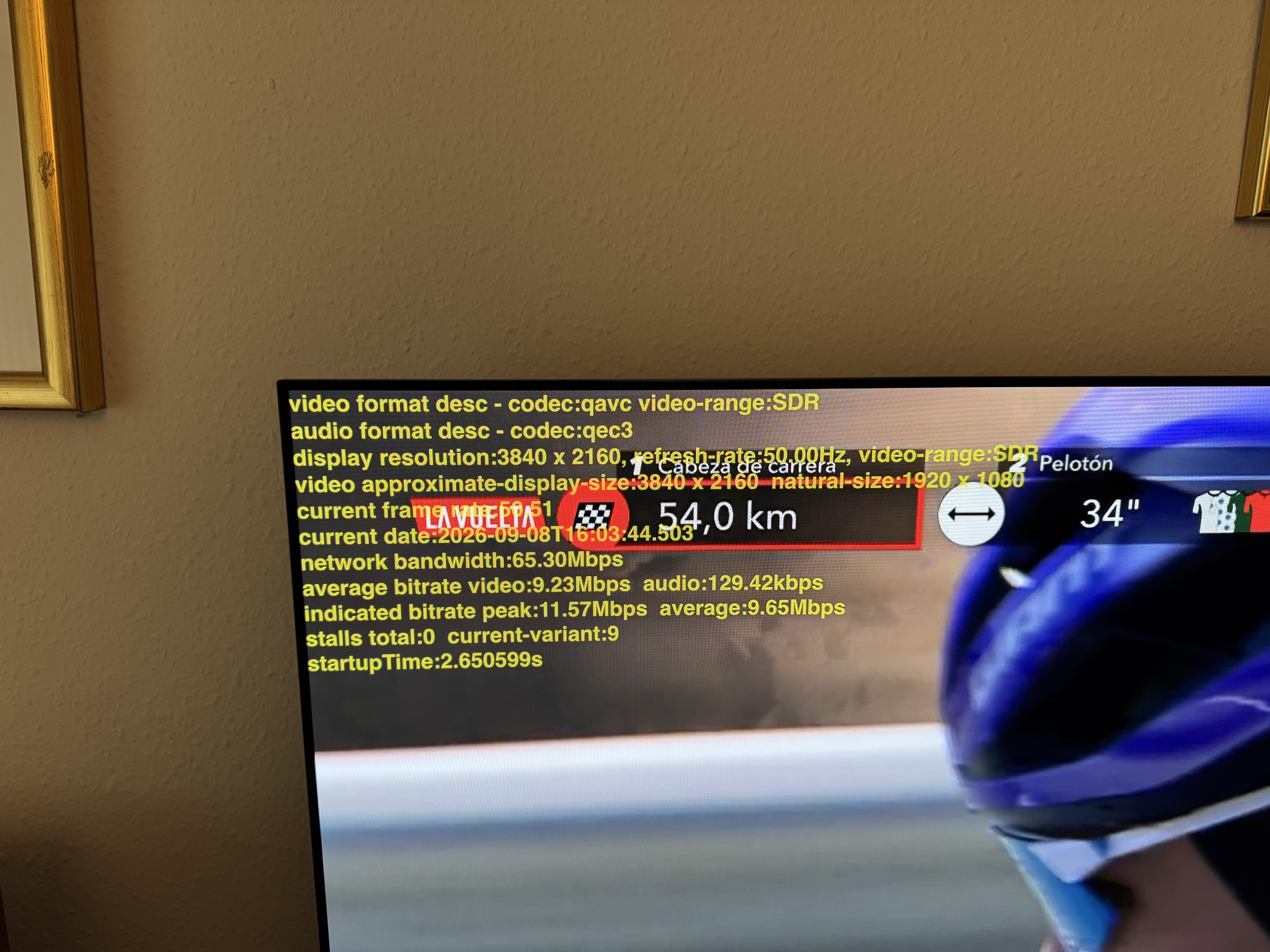

Vuelta la España på HBO
video format desc - codec:qavc video-range:SDR
audio format desc - codec:qec3
display resolution:3840 x 2160, refresh-rate:50.00Hz, video-range:SDR
current frame rate:50.84
current date:2026-09-08T16:03:54.503
network bandwidth:60.88Mbps
average bitrate video:9.36Mbps audio:129.42kbps
indicated bitrate peak:11.57Mbps average:9.65Mbps
stalls total:0 current-variant:9
startupTime:2.650599s
EDIT: DET VAR FORKERT TEKST FØR
Senest rettet af Brixen 12 sep 2026, 13:31, rettet i alt 8 gange.

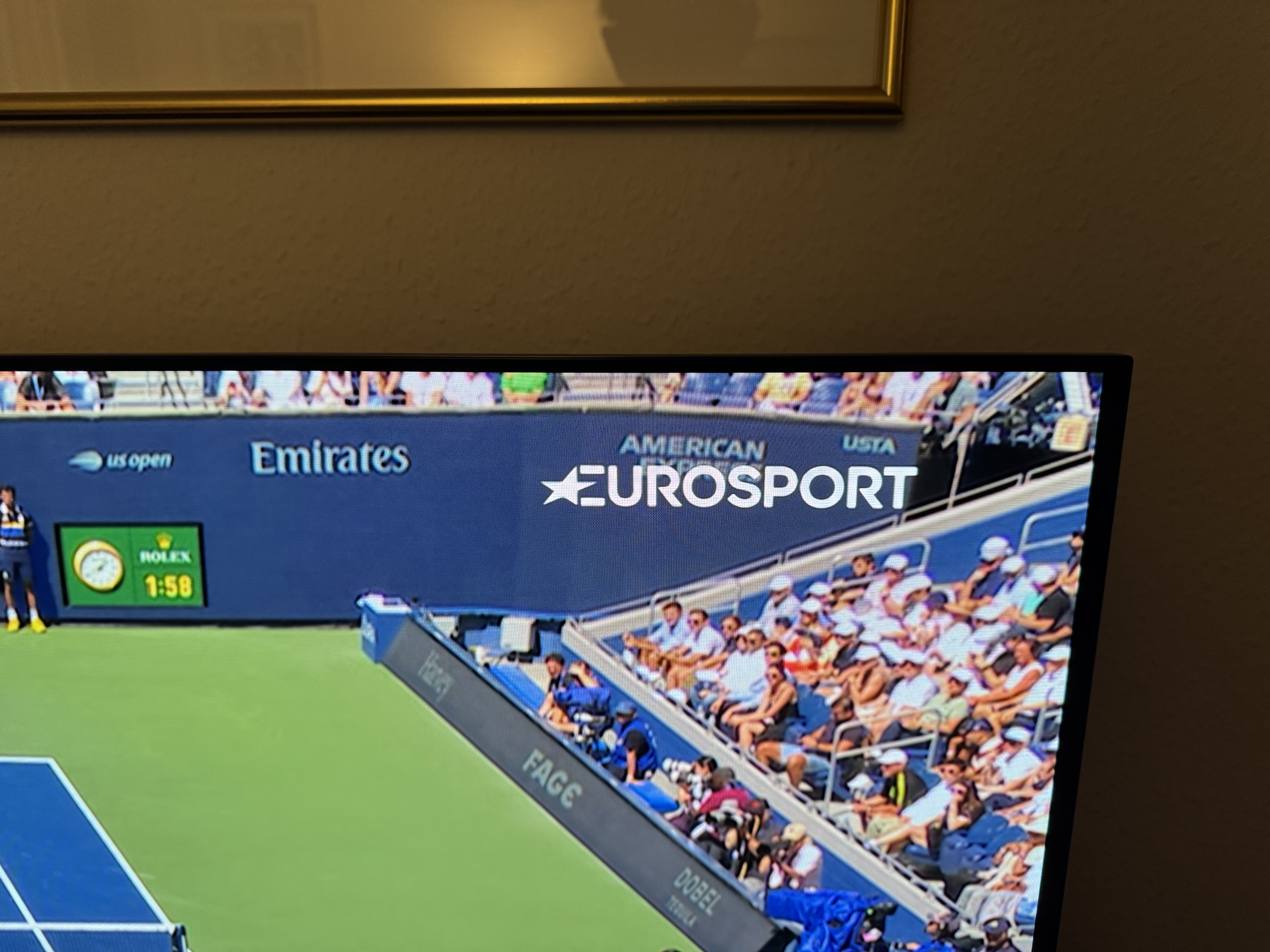

Ang DolbyVision på HBO Max i USopen tennis:
EUROSPORT logoet er så kraftigt, at det næsten blænder. Jeg håber ikke det brænder fast på mit LG OLED TV.
Det kan ikke ses på billedet hvor kraftigt logoet er.
